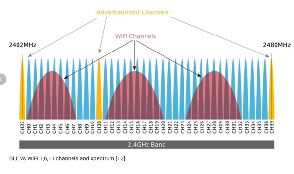

  • In case we are not using PTA and with reference to following figure, WiFi chip is sending data on Channel 1 and BLE chip is sending data on CH35 at the same time. Then both signal get transmitted properly OR they get collide with each other and requires retries? Any white paper on this theory available, then please share.
    Assuming that both devices function well - i.e. do not transmit out of their channel and do not change channel before the other transmission is finished - both signals should go through.

    My query- In case we are not using PTA and with reference to following figure, WiFi chip is sending data on Channel 1 and BLE chip is sending data on CH35 at the same time. Then both signal get transmitted properly OR they get collide with each other and requires retries? Any white paper on this theory available, then please share.
    Clément  reply - Assuming that both devices function well - i.e. do not transmit out of their channel and do not change channel before the other transmission is finished - both signals should go through.
    My query on Clément reply - What i understood here, in case we are not using PTA for our Gateway application and Both device (WiFi and BLE) transmit their channel at the same time, then transmission will not finished. In that case both device will retries. Is our understanding correct?

  • Hi Yogesh,
    Your understanding correct.
    With that being said, in general the Wifi signal is stronger and may go through while the Bluetooth LE signal does not. In other words, in most of the cases, I expect only the Bluetooth LE signal to require a re-transmission.
    Please note that WiFi and Bluetooth LE have backed-in re-transmission mechanisms. However, re-transmissions affect application data throughput and power efficiency.
