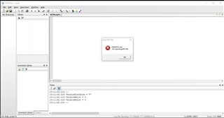

  • Hi Ryan
    I have downloaded the HCITester, but it is not successful in opening xxxx_6.12.26.bts files. I have tried the following steps (very similar to before), and the BT classic does work with these steps (with the correct HCI commands):
    1. FW initially loaded: TIInit_6.12.26.bts
    2. FW file put in place of original initscripts-TIInit_6.12.26_ble_add-on.bts
    3. Bluetooth service restart
    4. FW file put in place of original initscripts-TIInit_6.12.26_avpr_add-on.bts
    5. Bluetooth service restart
    6. hcitool -i hci0 cmd 0x3F 0x15B 1 1 (tried with and without this command)
    7. hcitool -i hci0 cmd 0x3F 0x177 0x01 0 0 0x71764129 0 0 0 0 0 0
    8. hcitool -i hci0 cmd 0x08 0x01E 0 37 0 (tried to send this once or twice)
    9. wait until we want to stop test
    10. hcitool -i hci0 cmd 0x08 0x01F
    Ville
  • This is the difficulty we are having with the tool
  • Hi Ville,
    I am able to recreate this issue when I have multiple instances of HCI tester running concurrently. Is this the only instance of HCI tester you have open?
    Thank you,
    -Ryan
  • Hi Ryan,
    I'm only running one instance I'm sure
    Are you sure the tool supports loading a BTS? Or do I need to convert it to a script first
    Ville

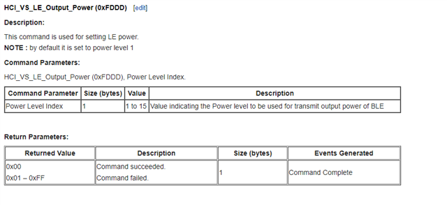

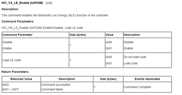

  • 1. There is an HCI command for testing the output power of BLE:
    2. There is an HCI command to enable/disable BLE as well:
    Let me know if there is any more clarification I can provide with these commands!
