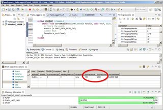

My ProjectZero based project which has been working with a UART read callback function has suddenly stopped having the UART read callback being triggered from one debug session to the next without me knowingly changing any code or project settings .

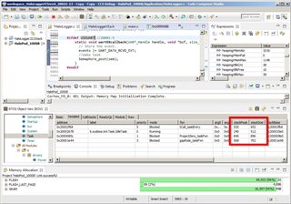

This is a large project (over 6000 lines of my own code added) and I am close to running out of both Flash and SRAM, however as reported by ROV, my stack sizes are fine (even too big for hwiStackSize) and my Heap usage is well below max size with no errors.

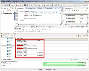

ROV does report some sort of Queue error as shown in the below images, do these Queue errors mean anything with regard to my current issue?
Are there any other ways of trying to find out why the UART read callback is not triggering anymore?

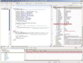

  • Here is the full UART code:

    I found hundreds of parameters related to UART status in the expression "uartCC26XXObjects" here are some, notably showing that the UART status is UART_OK in this debug session that has executed line 5967 to begin continuous reads yet the debug session is running and never breaks at the breakpoint on line 5974:
    If someone who understands all these hundreds of  parameters in the expression "uartCC26XXObjects" can tell me what tree to expand to further debug this issue it would be appreciated Slight smile

  • On a lark, I decided to try another of our identical custom pcbs which we have the CC2640F128 on.
    I guess somehow, the digital I/O pin on the 1st board suddenly stopped working since the 2nd board works fine with the above code.
    Topic issue resolved :) (I think)
    Now why would a digital I/O pin just stop working??
