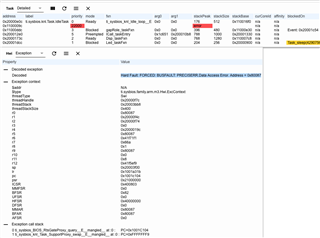

I am facing a problem when the SNV page is full. When it is full and I try perform a write operation, the program throws an exception and hangs forever. I think the page is erased after the writing because the data of SNV page is all 0xFFFFFFFF.
The exception is the following: "Hard Fault: FORCED: BUSFAULT: PRECISERR.Data Access Error. Address = 0x80087"
Exception call stack :
0 ti_sysbios_BIOS_RtsGateProxy_query__E__mangled__ at :0 :": "PC=0x1001C104
1 ti_sysbios_knl_Task_SupportProxy_swap__E__mangled__ at :0 :": "PC=0xFFFFFFF9
Below additional data about tasks, hwi, heap metrics and heap stats.
Please, can anyone provide me some direction for solving that problem?
Thanks in advanced.

    Everything works fine up to reach the last address of SNV page, the variables are overwrite several times and in random ways. I am watching the last address of SNV page with the Memory Browser. When the SNV page is full and I trying overwrite any variable in SNV page (the variable can be the lower possible) the program hangs forever.
    Before the program to hang I see that the SNV page is erased successfully. As you can see in my previous post the heap has 7096 bytes free so there is space in RAM for compaction of SNV page.
