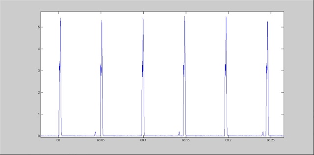

  • Hi Jan,
    Here is another BLE activity capture a little bit zoom in. Below there are 3 very small pulse I thought that is the VDDR recharge pulse.
    -kel
  • Hi Kel,
    Thank you for the additional picture. Are you observing this on a LaunchPad or a custom board? Can you try running the pinStandby project and recording the power graph as well? The graph for that project should contain the recharge pulses and will help us determine if the large spikes in your graph match up with the spikes in the pinStanby project.

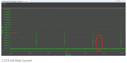

    Just for some comparison this is my Bluetooth Eddystone Beacon project running on CC2640R2F Launchpad. The peaks that reaches 7.319mA that happens every 200ms or so are the advertising interval. The one in red circle I assume to be the VDDR recharge pulse.

  • Hi Kel,
    It is possible those are connection events. Can your colleague take another measurement and zoom in further? If the outline of the graph matches the image shown below, then they are likely to be the connection events.:
    I would expect the distance between those spikes to change in accordance with the connection interval selected. Can your colleague try changing the interval and seeing how the spikes respond? That image is from the previously linked application report.
