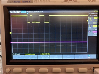

    When I mean LP-CC2652R7 dev kit RxD doesn't work. meaning it won't function.
    I connected TxD , RxD to a PC uart, running teraterm. teraterm received Data from dev kit correctly. but type on teraterm, dev kit won't get data, watch the RxD siganl. the waveform is deformed. seems RxD is driven the signal. without RxD connected, the waveform from PC's output is correct.

    the setting is correct. as teraterm receive data correctly. the RxD waveform is attached. you can see the signal goes low to 2V, it should go to 0V( where the yellow arrow, on the left, is )
    Cedrick

    I have a couple of follow up questions. Is the LaunchPad being powered externally or via the USB cable? Can take another waveform picture, but this time include the TX trace? If possible, in the image can you show activity on both the RX and TX lines to compare the voltage values of the logical high and low for both traces? Can you provide an image of the measurement set up? Is this behavior present on all UART examples or just the uartecho example?

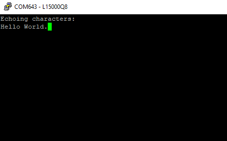

    I was able to successfully build and flash the the uart2echo_LP_CC2652R7_nortos_ccs example on the 5.40 SDK. The project was able to run on my LP-CC2652R7. I had no issues sending UART to the LP via the terminal and receiving the same UART back out which showed the RX and TX pins working as expected.
    q
    Can you provide the SDK you are using? If not on 5.40, then can you verify if the issue is still present in 5.40?
