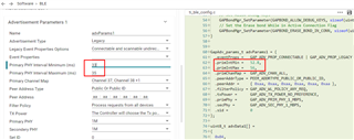

  • Hi Simon,
    I will ask the customer to provide the error code, but since this issue is tricky to reproduce, it may take time to catch the error code.
    Regarding to the primIntMin/primIntMax values, that is also what I want to discuss: actually these values are generated by Sysconfig. When a user inputs the Primary PHY Interval Minimum/Maximum which is in millisecond, the Sysconfig tool automatically converts the millisecond to the primIntMin and primIntMax value. When the Sysconfig inputs are not integral multiple of 0.625ms, the converted values will be a decimal number.
    I understand that the decimal numbers are not matching the uint32_t type, but it seems to work and there is no warrnings from Sysconfig or the compiler, so I'm not sure if the stack does some checking or it is just a coincedence. Could you please verify if this is an existing bug for Sysconfig? I also suggest to add some warning when user inputs are not integral mutiple of 0.625ms.
