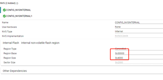

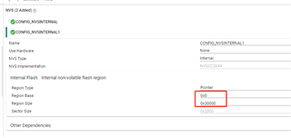

    The flash erasing issue has been resolved, while here's a new condition:
    The customer is cropping and writing OTA programs in official persistent_app engineering. Now they find that flash space is not enough. Is it possible to change the default nvs assignment of 2pages to 1page? This gives an extra 8k of flash to write to the downloader. However, after changing the SIZE and persistent_app start addresses in .syscfg and .cmd, it still report the error "addresses overlap".
    Thanks and regards,
    Cherry
  • Hey Cherry,
    It should be possible to only use 1 nv page. Have you also modified the linker file inside the simple_peripheral_oad_onchip example? You will need to make sure both that project and persistent_app is modified correctly to avoid overlapping segments.
  • Hey Ammar,
    The customer also modified .cmd, .syscfg, and so on in the user program multi_role, but still reported an error.
    Could you help list the linker file so that they can check one by one and confirm the overlapping?
    Also, after nvs only assigns 1 page=0x2000, does the SNV_ID range: 0x100~0x11F need to be changed?

  • Hey Cherry,
    I was not able to reproduce this on the default examples, but I have some steps the customer can try.
    In persistent_app:
    1. Define NVOCMP_NVPAGES=1 inside the project's predefined symbols.
    2. Set the SysConfig NV region to 0x2000 (like you show in your screenshot above).
    3. Open the project's linker file cc13x2_cc26x2_app.cmd (if using CCS, this is located inside C:\ti\simplelink_cc13xx_cc26xx_sdk_6_10_00_21_eng\examples\rtos\CC26X2R1_LAUNCHXL\ble5stack\persistent_app\tirtos\ccs
      1. Edit IMG_A_FLASH_START and set it to 0x00036000.
    4. Open the project's RTOS config file persistent_app.cfg
      1. Modify the m3Hwi.resetVectorAddress to 0x00038090; (if curious, the 0x90 is to account for the security header. The persistent app enables security by default.
      2. 	else
        	  m3Hwi.resetVectorAddress  = 0x00038090; //change this to 0x00036090; secure persistent app
        	  ROM.constStructAddr = 0x39000; //tables TI rtos uses
        	  ROM.externFuncStructAddr = 0x393C0;
    In simple_peripheral_oad_on_chip, repeat the above steps, except #4. Note, for item #3, you will need to modify the simple_peripheral_oad_on_chip's linker file separately. Please navigate to that project path to find that linker file. I would also caution on changing the linker files directly (you will lose the original SDK contents). Make sure to back the linker file up or save a copy so that you can revert any change.
    Hope this helps.

    The customer just followed the steps you given except for step 1, and changed 0x00038000 to 0x00034000. And leave nvs allocation 2page=0x4000 unchanged, only compresses user APP space, but it still reports an error.
    To use one page NV, I would make sure to define the predefined symbol and set it to 1 as stated. What is the motivation to reduce the start address by 0x4000? The persistent app will save 0x2000, and then you must also make a similar change on the other side (simple_peripheral app) and you can save another 0x2000.
    To help me understand better, does the customer only want to save space in the persistent app?
    I'm a bit confused as the screenshots provided show Region base at 0x30000, why is this?
  • Hey Ammar,
    The customer actually is wanting to expand the persistent app space, which is not enough to write OTA private protocol program.  And the user app space was redundant. So they want to compress the user's APP flash space for the persistent app project. They move the 16k(=0x4000)flash space for the persistent app.
    This Region Base at 0x30000: is by a small shift of 0x34000 to 0x4000.
    nv still uses the default 2 page.
    Thanks and regards,
    Cherry
