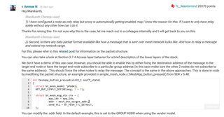

    I would refer to the other thread where I show the struct you use to pass in the target address for the message.

    2) W.r.t publish/subscribe paradigm I was able to create a group and give On/Off messages to that group can see that nodes(subscribed to the group address) are receiving them, this is successful.The way shown in below picture.
    But my focus is, a particular node has to publish to a group address and all the node subscribed to that group has to receive the published messages please suggest me a way to do so for 1 and 2.
  • Hey Manikanth,
    Thanks for explaining, I see where the gap is. You are correct, there really is not a way to assign the addresses if you aren't sure what your provisioner will assign. This can be solved at the application layer by defining a specific group address and using the publish/subscribe paradigm. You can also I guess create a custom network where upon provisioning, every node broadcasts its element addresses and shares the information necessary for you to use strategically. Are you able to share some details regarding the project you are working on? If you can share some details, I can help advise what would be best in your scenario.
    For #2, the On/Off message approach is exactly that. If you want something custom, you can use a vendor model instead of the SIG defined On/Off and have those nodes subscribe to the group address for that model. The process of subscribing/publishing is the same across nodes, so I'm not sure what more I can add to this answer.

    Publish/Subscribe paradigm - I was able to do it as shown in the above image, which is nothing but publishing from unicast address 0x0001 to a particular group right.This is smooth but publishing messages to a group from a unicast address other than 0x0001 I see it is not happening.
    Left over part is : I was only able to send from 0x0001 to group but not from other elements or other  unicast address to a group.
    Node to node message transfer(through unicast address): This is achieved in the case of Low power node and a friend node.
    Left over part: I was not able to send from Relay+proxy node to Relay+proxy node by just giving unicast address to one of them and send it to other.
    Node to many other nodes: This is similar to publishing messages to a group from a node(precisely from a unicast address other than 0x0001) which I was not able to achieve .(Left Over)
    I guess I've made all the points very clear  please give attention to "Left over" description.

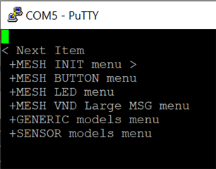

    What are those Generic models menu, Sensor models menu, can we use that to communicate from node to node. If so please let me know.

        All the scenarios which I have mentioned are passed and working fine. I was able to send node to node, node(other than 0x0001) to a group address.
    All my interested scenarios are passed successfully.
    I have used Generic models menu to do all the scenarios using Launchpad buttons.
