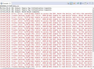

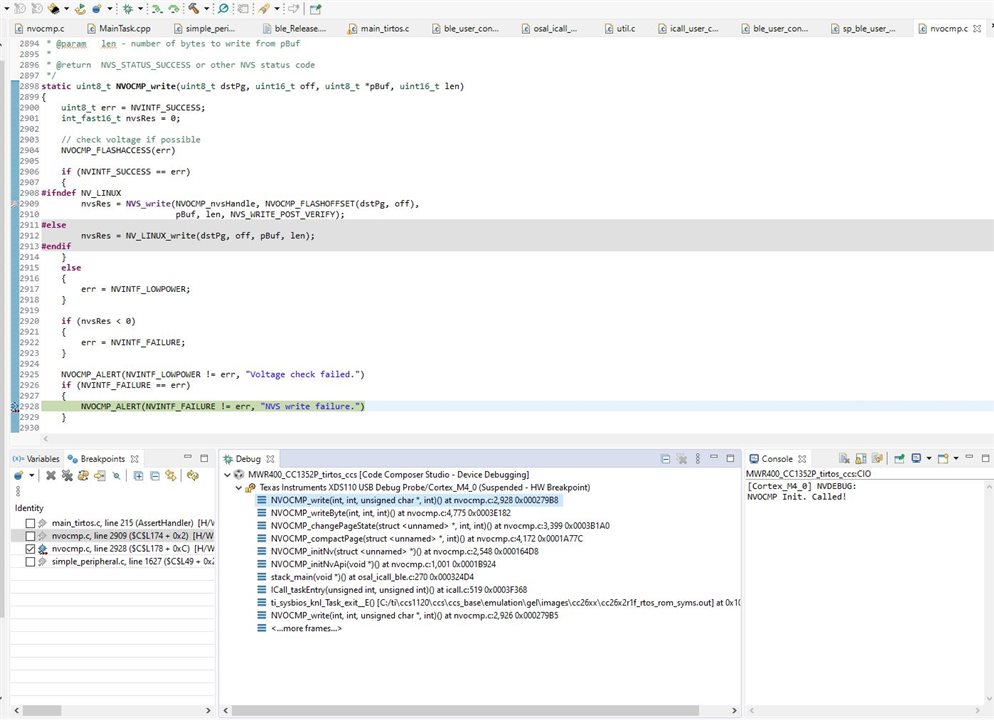

    Enabled NVDEBUG compiler flag and noticed that on boards that reset upon BLE connect,  There is an error on calling NVS_write() during ICALL initialization. Attached screenshot
