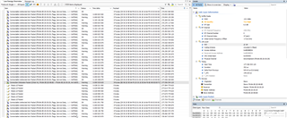

My simple peripheral example is based on SDK 5.10. I am also using RF Block mode as well. The connection request  is made from the BTool with connection interval of 30 ms and Supervision timeout of 2 seconds.
As soon the stack sends GAP_LINK_ESTABLISHED_EVENT in the application, the firmware is calling DMMPolicy_setBlockModeOn() to enable the RF Block mode to ON for almost 200-250 ms before disabling the RF Block mode.
I am seeing that the connection is resulted in termination in case the RF Block mode is ON for 200 ms. If I start using the RF Block after the 1st connection interval rather than enabling it after receiving GAP_LINK_ESTABLISHED_EVENT, the connection is successful.

    Thanks for the information. I am just wondering about the BLE stack and the BLE specification expectations from the time GAP_LINK_ESTABLISHED_EVENT is received in the application. If the connection parameters are having interval of 30 ms, slave latency 0 and supervision timeout at 2 seconds, I expect the termination for the connection should not happen before 2 seconds i.e. Supervision timeout. From the Ellisys sniffer, I can see that there is no further connection parameter updates/security exchanges (not supported by our application anyhow), tec.

  • I do not have the sniffer file itself but I have an image of the sniffer. See atatched.
  • Hey Mehul,
    Thanks for the screenshot, this clarifies things. From the log, it looks like the peripheral (rightfully so), does not show up to the first connection event. The first connection event is critical, I gather this from the specification.
    In v5.2, Vol 6, Part B, Section 4.5. Connection state, it states that the connection is created but not established until the peer receives the first packet. Further down, the spec states the first packet received by the peer determines the anchor point for all subsequent connection events. Slave latency is not to be used until the peer receives a packet from the master with the NESN bit set to 1.
    So, it seems in the beginning of a connection, attending the first connection event is critical to continue a connection appropriately.

    When block mode is on, the stack will attempt to send out connection events but these attempts will be rejected. At this point, the stack should handle the rejections and it should change its state back to a non connected state. I'm not too sure of the details, but I know there is a timeout based on a certain number of retries.
    Do you see a GAP_LINK_TERMINATE_EVENT get triggered? I think the stack should return such event to the application so that its aware of the state change as well.

    I ran some tests at the application level by turning block mode on as you have on one of our out of box examples. I consistently saw ~6 retries using different connection parameters. For example: with a ~200ms connection interval approximately 1.12 seconds elapsed before the stack sent the GAP_LINK_TERMINATE_EVENT to the application.

    This number is defined in the specification. See spec v5.2, Vol 6, Part B, Section 4.5.2 Supervision timeout. It states if "the connection supervision timer reaches 6 * connInterval before the connection is established...". It goes on to state the connection is then considered lost.
    In our code, we define this in ll_common.h, under the define LL_LINK_SETUP_TIMEOUT.
