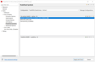

I am trying to increase the MAX_PDU_SIZE up to 512 but facing some issues. I am using the BL5 SimplePeripheral Program. I tried using different PDU Sizes, I am able to set MAX_PDU_SIZE = 251.
When I go beyond this Number, I face a Bluetooth connection issue with the smartphone.
Is there anything else need to take care of? Please let me know,
