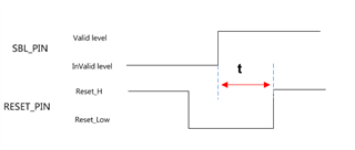

Hello, TI, Could you introduce the time define for the pin level for ROM boot? I don't know the miniumum time definition for the valid level of the pin config for boot.

How about the BL_pin valid level keep time? the same as Reset_N? at least 1us?
so, there must be case that 1 us valid wave occurs at BL_pin and reset_N at the same time, CC2640 must go to ROM boot mode?
The BL_pin needs to be kept at the valid level after the reset line is restored so that when the MCU boots it is able to determine whether to enter bootloader mode. The CC2640 will only know to enter the ROM bootloader if the CCFG has been configured properly. You can find out more from swra466.
