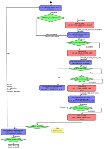

In our application, we are looping through the following actions:
1. Post for an application event to call GAPRole_StartDiscovery with whitelist enabled for a specific device
2. On receiving the GAP_DEVICE_INFO_EVENT, we initiate for a connection with the found device by posting another application event to call GAPRole_EstablishLink
3. On receiving the GAP_LINK_ESTABLISHED_EVENT we are posting for an event to call GAPRole_CancelDiscovery and parallely post an event to disconnect the above link.
After step 3, neither are we receiving any GAP callbacks for GAPRole_CancelDiscovery (which was called with status as SUCCESS) and neither is the application queue message to disconnect (which was enqueued without any error) getting dequeued. The stack message received after the above stall is HCI_BLE_HARDWARE_ERROR_EVENT_CODE which would mean that the heap has some failure?
Also please note that we  are using a dynamic allocation for the application queue and the queuing is happening successfully without any heap failures.
After sometime the device under test will reset.

    On further analysis of the HCI_BLE_HARDWARE_ERROR_EVENT_CODE, we also found that the hardwareCode from the hciEvt_HardwareError_t type pmsg is HW_FAIL_UNABLE_TO_SCHEDULE(0x8F).
    Here is the flow of events in our application:
     ScanAndConnect.pdf
    Hope this helps.
    Niranjan
  • Hi Niranjan,
    Thank you for the additional details provided.
    HW_FAIL_UNABLE_TO_SCHEDULE is raised when the scanning or the advertising did not get any scheduled time, meaning there was starvation for scanning or advertising because the other RF operations keeps on taking scheduling time.
    Based on the description you have made, I wonder if the Bluetooth LE controller (and in particular the scheduler) could actually be confused by getting (almost) simultaneously so many combination states (connection, scan stop, disconnection, while still being advertising).

    1. As you suggested that this issue maybe due to too many RF operations, I removed all the operations with respect to advertising and connection, I had only the scan operation running. - The same HW_FAIL_UNABLE_TO_SCHEDULE came up.
    2. I further simplified the scan flow by removing all HCI whitelist APIs and just toggling between scan cancel and start operations as follows:
      With the above logic running, the error HW_FAIL_UNABLE_TO_SCHEDULE was produced.
    3. I tried replicating the same flow on the multi role project from simplelink_cc2640r2_sdk_4_40_00_10. I have attached the multi role c file with the above scanning loop simulated. 8508.multi_role_simulated_Scan_Loop.c
      The same
      HW_FAIL_UNABLE_TO_SCHEDULE error was observed.
      Also, the timing from when the above loop has been started till the HW error is not fixed. We saw the error in 2-3mins in one test cycle and in 20mins in the other test cycle.
