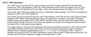

I have a question about cc2640 uart programming. I have downloaded uartecho sample but it does not work (example from resource explorer). I am using launchxl-cc2640r2 board. I tested gpio interrupt sample that works. I tested pwm sample that works too.
How can I use interrupt to get input serial data? The lib uart does not seems to be able to do so.
