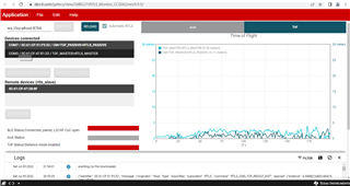

HI,
    I 'm using CC2640R2 Development kit for AOA demonstration.   (CC2640R2 LaunchPad ; CC2640R2F precisely)
    env:  Windows 7 SP1;  ccs_setup_9.2.0.00013;  simplelink_cc2640r2_sdk_3_30_00_20
    I follow the step;https://dev.ti.com/tirex/content/simplelink_academy_cc2640r2sdk_3_30_03_00/modules/rtls_toolbox_ble3/rtls_intro/rtls_intro.html#modify-load-the-software
    and file:///C:/ti/simplelink_cc2640r2_sdk_3_30_00_20/tools/blestack/rtls_agent/README.md;
     At last the TOF works, but it seems AOA is not being enabled.
     Could you please tell me how to enable the AOA related functions?     And how can I get I/Q sampling of the CTE with SDK_3_30 ?
B.R.
hao

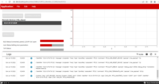

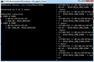

  • Sorry for so frequently questioning.    I found it will not work well if flash multi-boards using Flash programmer 2.
    So after I flash my 3 boards one by one,  now master can find slave BLE.
    But again it freeze(no move) at the setting AOA parameter step.

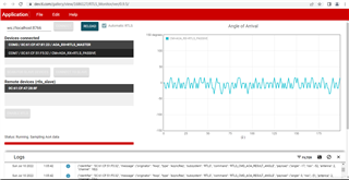

  • I change to use another RTLS_monitor 0.9.5(this one is for SDK 3.30, the other one is for SDK 3.20), and the AOA works.
    now the question is how to complete "Pin 29 will be held high" ?
    and how to set parameter ''Connection interval" in the project ?
    B.R.
    hao
  • hi,
    It shows that the Chrome is sampling I/Q data.  But where can I find it (I/Q data) ?
    B.R.
    hao
