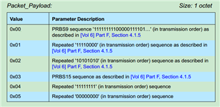

    I am really sorry that the cause of this issue is instrument measurement mistaken. according to our analysis, the instrument only can measure the power accurate if the ble packet is not whitened, so it shows right result when ble is in PTM mode but can't be applied to the whitened ble packet.
    as the ble specific Core 5.2 illustrated, all the le packets show be whitened to randomize the data from highly redundant patterns and to minimize DC bias in the packet.  what's the reason that the packet in PTM mode is not whitened. I have a conjecture, the reason is the packet payload(please see the attached picture for details), the ptm mode is employed to check the hardware design, so the packet should be the original other than whitened.
    Great that the output power variation in the measurement is identified. Need to ask a colleague to check why the packet in PTM mode is not whitened.
  • Hey Renfang,
    This is correct. If you, for example, are running a HCI_EXT_ModemTestTxCmd, this will transmit a carrier wave which is not whitened. This is usually used to test the RF PHY settings. When trying to capture a modemTestTx command, you'll have to use the HCI_EXT_ModemTestRxCmd command to receive this (because it is not whitened).
