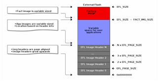

    We are having one query on implementing OAD off-chip.
    Step 1: I loaded the OAD_offchip and bim_off chip codes
    Step 2: I connected the device with starter link mobile app and I clicked the "TI OAD Service" from mobile app as per the image given below
    Step 3:  Now In Simple peripheral OAD off_chip application It is calling the "OAD_ProcessQueue" function -> Now It is entering into the "OAD_IDLE" State -> Now It is entering into the "OAD_WRITE_IDENTIFY_REQ" event -> Now it is calling the function "oadImgIdentifywrite" -> Now In this function it is entering into the else case of if(!useExternalFlas) -> Now it is calling "oadFindExtFlMetaPage -> Inside this function they are reading data from external flash as mentioned like below
    for(uint8_t curPg = EFL_FACT_IMG_META_PG; curPg < OAD_EFL_MAX_META; ++curPg)
    // Read in the metadata from ExtFl
    readFlashPg(curPg, 0, (uint8_t *)&extFlMetaHdr, sizeof(ExtImageInfo_t));
    Here we are reading from external flash using "extFlMetaHdr" structure.
    But Here query is  actually where we are writing into the external flash in our code ? because if somewhere we written this data to external flash then only we can read right ? so please provide the details like from code where we are writing these header details into the external flash.
    Why we are asking is -> We are using SPI flash in our project so same thing we have to write on my SPI flash and we have to read back while calling these  "oadFindExtFlMetaPage" function.
  • But Here query is  actually where we are writing into the external flash in our code ?
    The image is downloaded with the OAD_WRITE_BLOCK_REQ event, after the state machine switches to the OAD_DOWNLOAD state. The state is switched after the image is validated. The OAD_WRITE_BLOCK_REQ calls oadImgBlockWrite to do the task.
    Can you clarify the use case? You should not need to change the OAD files, just the flash interface. The specific logic behind the OAD state machine should not need to be modified. For information, checkout the flash_interface.h file.

    Our doubt is that this data read from external flash should be written somewhere in the code right?
    1) When we tried to put the above prints for our custom HW, we are getting the data as 0 for all, from this we understood the header data is not already written in external flash. So we are trying to find that piece of code to handle the header write on my custom external flash hardware but not able to find that part of code. Can you please tell us which part of the code handles this write? and during which state it is writing into the external flash?
    2) In our custom HW we are using different external flash part and  because of some issues we faced earlier we are using the spi_open , spi_write in our implementation.
    Now in OAD they are using nvs_write, nvs_open calls. Whether we can use spi_open, spi_write instead of nvs calls. Can you please confirm on this also ?
  • Can you please tell us which part of the code handles this write? and during which state it is writing into the external flash?
    You can track the calls to writeFlashPg to see when data is written to the external flash.
    Take a look at flash_interface.h. In theory you should be able to replace the flash_interface_ext_rtos_NVS.c file with flash_interface_ext_rtos (which uses just spi writes). Additional steps may be required. Our launchpad uses the an MX25R8035F SPI Flash, which is passed in to the NVS driver under the "Use Hardware" field (I would take a look at the generated ti_drivers_config.c file for the code).
    Taking a step back, have you tried to just remap the SPI hardware lines to match your custom part? Again, changes at the oad level should not be required and you should be able to use a different external flash part by remapping the SPI hardware and reconfiguring the flash_interface.
  • Hi Ammar
    We tracked all writeFlashPg calls and also OAD_WRITE_BLOCK_REQ this call, But still we are not to find the exact location where it is writing to the external flash. In oad_image_header.h we find a structure with const having the same as the header structure. Is it anything relatable?
    It would be more helpful if you mention with the piece of the code where the image header in the external flash is written
  • Hey Mohan,
    I think I may be misunderstanding the question.
    Do you want to know where in the external flash the image is written to?
    writeFlashPg() is the function used to perform the task to write to the external flash. When we write to flash, we pass in the page number (i.e.  "imagePage" the location in the external flash).
    Specifically, the image header should be written to in line ~1167, see below excerpt.
                    // Write a OAD_BLOCK to Flash.
                    status = writeFlashPg(imagePage, 0,
                                            (uint8_t * ) &candidateImageHeader,
                                            sizeof(imgHdr_t));
