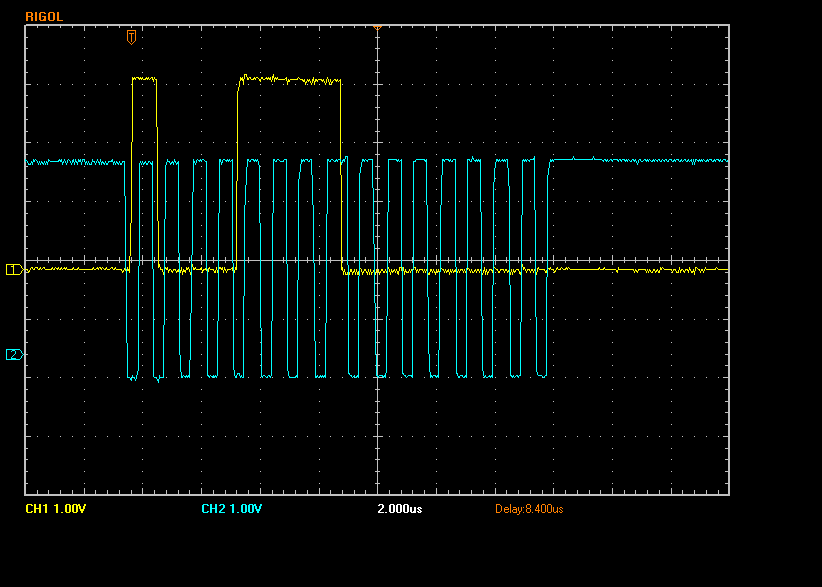

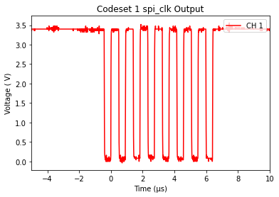

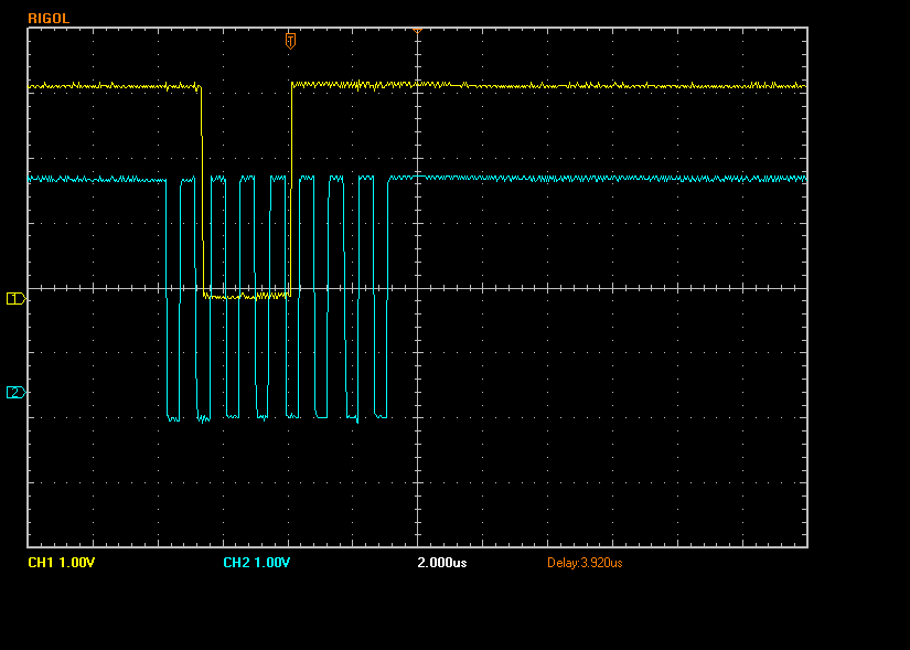

  • Hi Ryan,
    Good point. I can probe the launchpad easier this way, too. Running the same code, I can monitor the MOSI signal on channel 2:
    One Line Scope Plot:
    Two Line Scope Plot:
    The two line implementation writes the correct value of 8F for read bit (0x0080) logical and addr bit (0x000F).
  • Am I interpreting correctly that they MOSI is at a different default level depending on the implementation used (one-line vs two-line)?
    Ryan
  • Ryan,
    Yes, in the first case the default level is high, in the second it is default low

    //SPI_POL1_PHA1    First edge of SCLK is falling, MOSI/MISO propagated at first edge of SCLK]]></sccode>
            <sccode name="terminate" init_power_mode="0"><![CDATA[//Close SPI connection
    //spiEnd(SPI_POL1_PHA1, AUXIO_SPI_CSN_ACCEL_CSN);]]></sccode>
            <event_trigger active_count="1">0,1,2,3</event_trigger>
            <tt_iter>wait_10ms,run_execute</tt_iter>
            <tt_struct>output.partID</tt_struct>
            <rtl_struct></rtl_struct>
            <rtl_task_sel en="1" struct_log_list="output"/>
        </task>
    </project>
  • Thanks Barrett. Let me look into this and I will get back to you.
