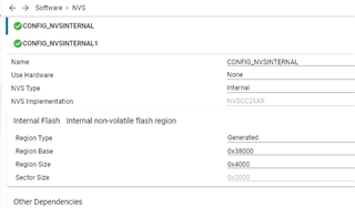

Part Number: CC2642R-Q1
When I set SNV,
build error:
Description Resource Path Location Type
#10324-D BOUND section ".TI.bound:flashBuf0" spans the boundary of an existing memory range FLASH_IMG_HDR persistent_app_CC26X2R1_LAUNCHXL_tirtos_ccs C/C++ Problem
<a href="file:/C:/ti/ccs1110/ccs/tools/compiler/dmed/HTML/10099.html">#10099-D</a> program will not fit into available memory, or the section contains a call site that requires a trampoline that can't be generated for this section. run placement with alignment fails for section ".TI.bound:flashBuf0" size 0x4000 persistent_app_CC26X2R1_LAUNCHXL_tirtos_ccs C/C++ Problem
