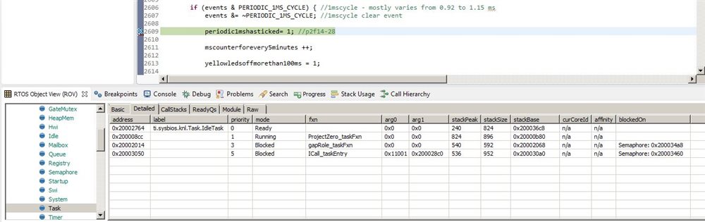

I have a big complex ProjectZero based project that includes 2 periodic cycle clocks (one at 1ms and one at 2000ms) , an external flash, I2C and UART code.
The code works well communicating with a UART device, four I2C devices, external flash and a BLE IOS App which I developed.
I have just recently been able to initiate a sleep/standby state of <10ua current after I sense that 2.8v has been removed from IOID_14 by stopping my periodic cycle clocks, stopping advertising on BLE plus closing all my pins, I2C, and UART.
Wakeup from sleep is triggered by an interrupt of IOID_14 when 2.8v is applied to the pin, at which point I restart my periodic cycle clocks, reopen all my pins/I2C/UART and start advertising on BLE again.
I have coded a yellow LED to only ever come on for 2 seconds (and then goes off) each time that the main.c main() function is run. This lets me know if there is a problem waking up that initiates the main() function code as in a restart that will start the RTC from zero and initialize all ram variables again (both of which should not occur after waking from sleep).
Running stand alone without debugging in CSS by JTAG cable, I apply 2.8 volts on IOID_14 during this <10ua sleep state and the Yellow LED comes on for 2 seconds. This is not an expected behavior.
To debug this issue I run a CCS debug session, run the code and then:
  1. Initiate the sleep by removing 2.8v from IOID_14
  2. I enable a breakpoint at a point where my 1ms periodic cycle clock trigger has been recognized in my ProjetZero_taskFxn loop.
  3. Apply 2.8v to IOID_14. At which point the code execution breaks at my enabled breakpoint which indicates that the pin interrupt has occurred, my ProjetZero_taskFxn loop has started again and my 1ms periodic cycle clock has triggered.
  4. I then begin single stepping through the code with F5 and after a few steps my code stops executing however the code stills runs/pauses and be continued.

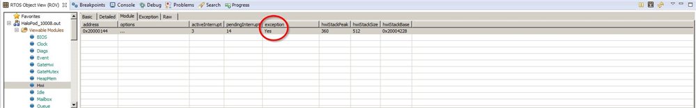

  5. When I pause in this 'hung' state I am able to use ROV to see that an Hard Fault: FORCED: USAGE: NOCP exception has occurred:

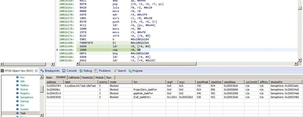

Most of the time in this 'hung' state is spent looping through the above 4 lines 1001b180 to 1001b188.
Here is a disassembly listing with RTOS ROV symbols added for an area just before that loop and up the the line where the loop exits to once in a while:

From that listing it appears that code is sometimes transitioning from ti_sysbios_knl_Task_schedule__I to ti_sysbios_knl_Task_allBlockedFunction__I.
Which seems to indicate that all tasks are blocked during this 'hung' state.
During this 'hung' state ROV supports this 'all tasks blocked' status by these images:
Can someone please help and/or perhaps suggest how to investigate the task scheduler and determine how/why all tasks revert to blocked after waking up?
Dale
NOTE: Here is the point in another topic where this issue was first discovered/discussed and eventually a decision was made to start this new topic:
https://e2e.ti.com/support/wireless-connectivity/bluetooth-group/bluetooth/f/bluetooth-forum/1109571/cc2640-minimizing-sleep-current-when-using-i2c-and-uart/4147714#4147714
  • Here is screenshot showing the code breaks, after wakeup is triggered, where my 1ms periodic cycle clock trigger has been recognized in my ProjectZero_taskFxn loop:
    This is as expected since this breakpoint would not be reached if ProjectZero_taskFxn were blocked.
    Only a few single steps after this, the code execution will enter the 'hung' state with all tasks blocked again.

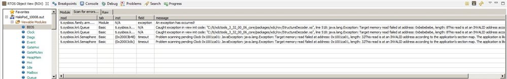

    The only HWI exception I have seen is shown in the first image of this topic and the 5 exceptions in the ROV BIOS listing a few images below that. (BOLD here is an edit)
    A breakpoint on the first line of main.c AssertHandler() function is never triggered during the debug session that results in the 'hang' state.
