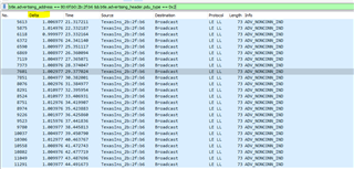

With the above configuration, Beacon #1 is not transmitted (but Beacon #2 is). I can "fix" the problem and get Beacon #1 to transmit in a couple ways:
- Reduce the interval for Beacon #1 to 950ms
- Remove calls to GapAdv_prepareLoadByBuffer and GapAdv_loadByBuffer (update the scan response data blindly)
This leads me to believe that updating the scan response data in sync with the advertisement interval is causing problems. Hypothesis:
- Task #2 calls GapAdv_prepareLoadByBuffer just prior to the advertisement interval for Beacon #1, which prevents Beacon #1 from being sent in that interval.
- Task #2 calls GapAdv_loadByBuffer and an advertisement is scheduled for the next interval (1 second later)
- Task #2 sleeps for 1 second
- Repeat
Please tell me: How can I update the scan response data periodically without preventing beacons from being transmitted?
