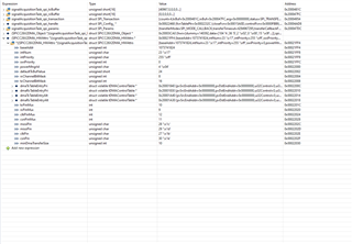

When SPI_transfer is called, an HWI exception is raised. Somehow the code hit the Hwi_excHandlerAsm. There is not much information i can gather from the ROV.
Investigation

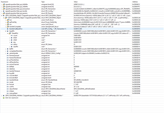

I suspect that there might be incorrect setup on the SPICC26X2DMA_Object and SPICC26X2DMA_HWAttrs. Hence the values before the execution of SPI_transfer is captured.
SPICC26X2DMA_Object
I wonder would it be the issue in the null head and tail Ptr which include the Hwi_excHandlerAsm pointer. Just a wild thought.

  • Hi Tony,
    I am assuming that you used the spimaster example as a basis for your demo code?  I agree that there must be an issue with initialization which causes a HWI.  Here is documentation concerning the SPI TI Driver for more information.  Which version of the SIMPLELINK-CC13XX-CC26XX-SDK, RTOS, and Compiler are you referencing?  Have you initialized a SPI module in SysConfig and does SPI_open successfully return a handle instead of NULL?  You can also review the Debugging Guide and furthermore copy the SPICC26X2DMA.c file directly into your project directory to further debug the functions included within.
    Ryan

    I think SPI_open() was implemented successfully. The object and hwAttrs shown above was provided by handle. In addition the fxnTable are pointing to the SPICC26X2DMA.c function. So i assume that the SPI_open method is kinda ok.
    Thanks for the attention. Meanwhile i will try to debug it as instructed.
  • ou can also review the Debugging Guide and furthermore copy the SPICC26X2DMA.c file directly into your project directory to further debug the functions included within.
    Welp. It is quite embarassing that i did find out where the problem is and it is quite stupid. Turn out it is indeed the handle issue. But anyway in direct inlucsion of SPICC26X2DMA.c file did help the debugging process.
    Thank you Ryan and I apologise for wasting your attention on this simple issue. Good day.
