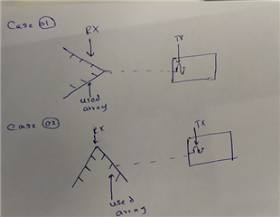

    The problem was not solved. I do not have a digital analyzer but I check the antenna pattern using a oscilloscope. For the patter [1,2] it shows rectangular waveform with 4us on time and off time ( for 28pin).
    However, I get always 90 degrees as the AoA whatever the angle between the RX and TX.
    Could you please tell me what should be the phase difference and angle of arrival for the cases described in the attachment.
    Danilo
  • Hi Danilo,
    Verifying the antenna switching pattern should be the priority here.Then, verify the antenna board is properly connected to the device's radio. Once this done, I recommend to verify the sanity of the IQ samples received by plotting the phase of the signals received by the two antennas on a graph.
