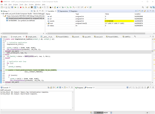

    • When customer debug, the return result of UART2_write() is stored in the status variable and the value of this variable is 0. Is it successful? But the serial port debugging assistant doesn't show any output.
    Regards and thanks,
    Nick
  • I suggest using UART2 unless there is a need for the BLE5-Stack’s NPI.  Nothing appears incorrect from looking at their initialization code.  A zero being returned by UART2_write indicates a UART2_STATUS_SUCCESS.  This could be a hardware issue, is the customer using a LAUNCHXL-CC26X2R1 or custom PCB?  Have they tried using different DIOs for the RX/TX pins in SysConfig or do they need to select "Use Custom Board"?  They should verify that the uart2callback example works as expected.

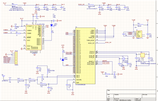

    What's more, could you please check this circuit diagram from customer, he tested the pin of CC2642 and found that the TX pin of the serial port has no waveform at all, and there is no waveform after replacing several pins as TX.
    Best Regard and Thanks,
    Nick
  • You had earlier stated that they could get LEDs to flash in accordance with their firmware, this would confirm that the main core is active and running.  Nothing appears out of the ordinary in their schematic at first glance, but there could also be an issue with their layout.  They should apply to SIMPLELINK-2-4GHZ-DESIGN-REVIEWS for further review.  I would expect they could build uart2callback if they have simple_peripheral working, you could also try a UART TI Driver example if it is available as a proof of hardware operation.
