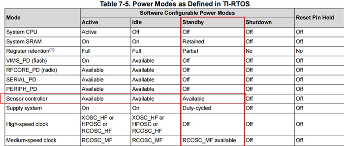

In Standby mode, the Sensor Controller is in the Available state. Can you turn it off completely so that it does not consume power? What is the method?
swcu185e -《CC13x2, CC26x2 SimpleLinkTm Wireless MCU Technical Reference Manual》:
  • Hi Rain,
    The Sensor Controller core is already disabled by default and does not turn on until explicitly enabled from the main core application.  Hence examples such as gpiostandby are able to give an accurate depiction of low-power standby operation at ~1 µA without mentioning the Sensor Controller, which would add 30.1/808.5 µA to the total.
