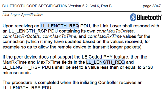

    1. Based on the results of the forum search, the current assumption is that the BLE-Stack of the Android devices is faulty. Since disabling DLE in the local feature set seems to make it work, the problem seems to be connected to the LL_LENGTH_REQ send by the peripheral which is responded with an LL_REJECT_EXT_IND by the Android device. Can you point out the error here? Is LL_REJECT_EXT_IND not a valid response to a LL_LENGTH_REQ? I've tried looking through the BLE Specification, but was unable to determine a definite answer which responses are valid here. This would help in communcation with the supplier of the Android devices.

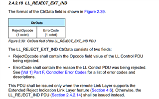

    When an LL_LENGTH_REQ PDU is received, the link layer must respond with an LL_LENGTH_RSP PDU even if DLE is not supported. It should contains the parameters that the device supports. Information on this can be found in section 5.1.9 Data Length Update procedure of the 5.2 Bluetooth Core Specification.

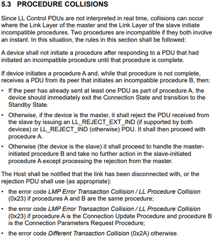

    The LL_REJECT_EXT_ID has an ErrorCode section in the CrtData field.  I am unable to parse the provided trace fields as BLE packets on my end. The [Vol 1] Parf F, Controller Error Codes section of the Bluetooth Core Specification contains a list of all the error codes that could be generated here as well as their purpose.
    One of the reasons an LL_REJECT_EXT_IND (or LL_REJECT_IND) can be sent is due to a procedure collision. Section 5.3 Procedure Collisions of the specification may provide further insight here:

    The error code in the LL_REJECT_EXT_IND seems to indicate a transaction collision.

    Got it. According to the specification, the central device should only respond with the LL_REJECT_EXT_IND if it receives a procedure from the peripheral that conflicts with the procedure that was last sent/started by the central device.  Is there another LL procedure being started before the central receives the LL_LENGTH_REQ? For example, does the central send an LL_LENGTH_REQ before the peripheral sends its own? If so, then what should happen is that the peripheral's procedure is rejected, and the central's procedure proceeds to be completed.
    Jan
  • Hi Jan,
    Not as far as I can tell. The central sends its own LL_LENGTH_REQ a few connection events later. There is an LL_CONNECTION_UPDATE_REQ before, but its instant has already passed by the time the peripheral sends the LL_LENGTH_REQ.
    traces-txt.zip
    Even then, as I understand it, a LL_LENGTH_REQ does not have an instant, and thus Vol 6, Part B, Section 5.3 should not apply here since collisions require incompatible procedures, which are defined as two procedures involving instants?

    My apologies, you are correct. Section 5.1.9 Data Length Update procedure (shown below) details what should happen when an LL_LENGTH_REQ is receives and what should happen if a LL_LENGTH_REQ is received as a response to a LL_LENGTH_REQ. It seems that the Android device is not handling the back-to-back LL_LENGTH_REQ when it should be able to simply use the parameters in the request to perform the procedure.
    This collision should be harmless if the spec is followed.
