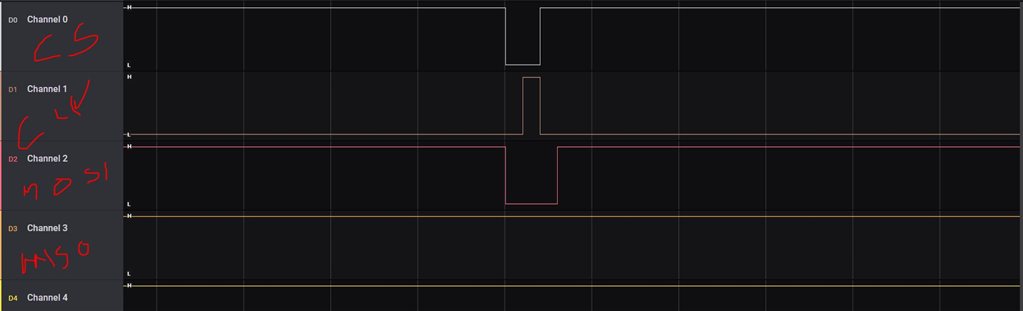

    Yes, I understood. We are using a 16Mbit Windbond flash. Here i attach the read and write signals, when writing and reading the flash info (as per ExtFlash.c) taken using Salae logic analyzer.
    Write -
    const uint8_t wbuf[] = { BLS_CODE_MDID, 0xFF, 0xFF, 0x00 };
    extFlashSelect();
    int ret = Spi_write(wbuf, sizeof(wbuf));
    Read
    ret = Spi_read(infoBuf, sizeof(infoBuf));
    CS and CLK lines are tapped on the PCB. MOSI and MISO lines are just connected to different pins (for testing) and not actually tapped into PCB. So please ignore the MISO lines (not supposed to get any data).
    Could you please clarify me if this is an expected behavioiur, "How does the CS pull high before completing the Write operation (as observed in figure 1) ? "
    From my understanding and based on the windbond flash datasheet, this is incorrect.
  • Write 4bytes (0x90,0xFF,0xFF,0x00) ---  (sampling rate increased to 8 Ms/s). MOSI and MISO not connected.
    Read (Manufacture and Device ID) - (sampling rate increased to 8 Ms/s). MOSI and MISO not connected.

  • As asked, please find the waveforms with all signals (SCLK, CS, MISO, MOSI):
    Please find the Instruction sent for reading Manufacture/Device ID, but while Reading MISO line gives 0xFF instead of actual data.
    Flash Write :
    FFlash Read:
    Thank you for sharing.
    Do you see any activity happening on the "MISO" line? (here it looks like the MISO line is always "high").
    At the moment, I suspect a hardware issue may actually happen. I mean, from the software point off view, we cannot fix much - the SPI receives 0xFF and reports 0xFF, so from this point of view everything is "working".
    The next steps I suggest are:
    - verify if the MISO line can be properly driven by the external flash. One approach could be to try to send other commands to the flash and see if the line toggles.
    - if the previous is not successful, consider to perform a hardware review. To me, the most efficient would be to have the inputs from the W25Q16JV flash support team. You can also request a design review from TI (see https://www.ti.com/tool/SIMPLELINK-2-4GHZ-DESIGN-REVIEWS).
    I hope this will help.
    I am now closing this thread as the issue is probably not at the software level. Please consider opening a new thread is additional support is needed.
    Clement
