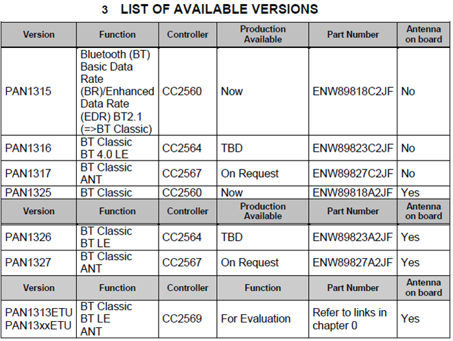

  • On that page, if you click "Resources - Click to Expand/Close" you can download the "PAN1327-1317 Full Specification"
    In the "PAN1327-PAN1317 ANT - Addendum.pdf" file it mentions all of the modules in development.
    This is where the PAN1313ETU/CC2569 is mentioned that has BT LE in addition to BT and ANT. Is the part number or sample silicon available yet?
    I did find the PAN1327 on digikey: http://search.digikey.com/scripts/DkSearch/dksus.dll?Detail&name=P14773CT-ND Under $20 in larger quantities isn't too bad. (its less than $1 more than the non-antenna version, which is nice)
    In "PAN1315 Core Specifications.pdf" on page 27 it mentions a recommended footprint pattern for the PAN1315.
    Does that footprint apply to all of the different radios? If that footprint is accurate for every one of the modules listed (so I can use whichever one I need) then I can start drawing it up.

  • William,
    The footprint for all PAN13xx modules is common, so you can use the PAN1315 module information to design. Therefore, you can design now, leverage what exists and possibly upgrade in the future when they are available.
