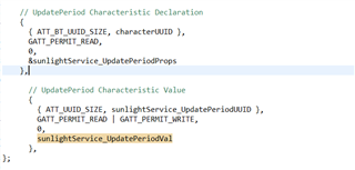

Customer wants to send EEG data via bluetooth. The data is 6 bytes and how to make these data sent by setting a certain frequency interval?
Customer's understanding is to always update the structure corresponding to a service feature which is the sunlightService_UpdatePeriodVal in the first figure. But he found that project_zero is a thread of the main function, so can him create another EEG acquisition thread to update this sunlightService_UpdatePeriodVal array data? If not, what should him do to make bluetooth always send a 6-byte data which is a always-updating array?

  • Hi Nick,
    If the customer is interested in sending data at a fixed frequency, then I would suggest implementing a timer or clock callback at the desired time interval. Within the callback, a GATT notification can be enqueued to send the newly updated data. I would suggest referencing the simple_peripheral project as this project has a periodic event built in by default that can be used as a starting point to implement the desired functionality. To learn about notifications and how to work with them, then I would suggest the customer reference the Generic Attribute Profile (GATT) chapter of the User's Guide, the HID over BLE example, and the throughput_peripheral example. The examples show how to use the GATT_Notification() function and the documentation provides some theory behind how notifications work. The Clock chapter of the user's guide also contains valuable information on how to set up periodic events.

  • Hi Jan,
    If there is no need for a certain interval, as long as there is data, it will be sent immediately? How should 6 bytes of data be sent?
    Nick
  • Hi Nick,
    If there is no need for a certain interval, then the customer can simply write the data to a custom characteristic and if the peer device has enabled notifications, then they will received a notification whenever the characteristic is updated.
