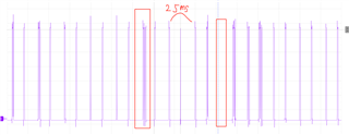

    By observing the radio frequency mapping LNA, it is found that on a connection event, there are sometimes multiple LNA pulses (1-4) with an interval of about 260us. These 4 LNAs mean that there are 4 data packets sent in this connection event? They set the connection interval to 25ms, the data is 90 bytes, and the MTU is set to a maximum of 255. What's more, it may not be enough for data copying with an interval of about 260us.
    The LNA picture is shown in the following figure:

    Again, there is no way to have several re-transmission in the same connection event as the connection event is considered as terminated as soon as one  packet is not acknowledged.
    Here, the screenshot shows the transmission of chained packets (i.e. several different packets, NOT the same packet being re-transmitted).
    Correct.
    The packets received are stored in the radio RAM and pushed back to the application core when it is ready. Having such short delay between the reception of Bluetooth LE packet is expected and fully supported by the device.
