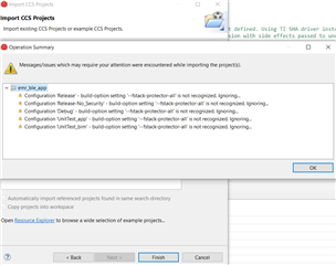

I am using the TI SDK v5.10 building BLE stack. By default, the project uses armcl compiler (ti-cgt-arm_20.2.4.LTS) from the CCS v10.3.
I was wondering if any of the example BLE project can be built with compile time options like "-fstack-protector" using armcl compiler? Whether TI recommands to use this option? I tired definign this option in the projectspec file and then while importing, I have got an error that this option is not recognized:
I was gogin through few materials from TI and have found that above compile time option is available in tiarmclang compiler but not in armcl compiler?
https://software-dl.ti.com/codegen/docs/tiarmclang/compiler_tools_user_guide/compiler_manual/using_compiler/compiler_options/instrumentation_options.html
Also, TI mentioned that the armcl compiler will not longer be updated unless for bug fixes and instead, the developers should use a new tiarmclang compiler. Is my understanding correct?
