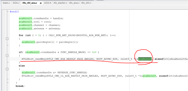

  • Hi Clément,
    Customer gives us more detail about this issue:
    1. He found this function in the rtls_ctrl_aoa.c file. The customer's understanding is to send the value of the aoaResult via this function, so the aoaResult inside of this function is the angle value. Is he right?
    2. What is the main difference between the three .c files in the following figure?Are the two calculated angle values, rtls_aoa.c and rtls_ctrl.c, related to the transfer?
    Nick
  • Hi Nick,
    1- Yes correct, this is the right function.
    2-  I do not understand the question here. Please refer to the comments in the files if more details are required.
