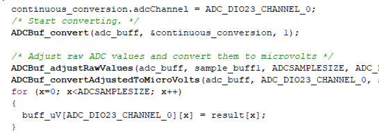

Customer have CC2652R7  ADC measuring across a 1V range for vehicle voltage, 12/24 volt operation, and the voltage ratio to measure is 30.4:1, across 1V reference.  On one device, the see that this conversion of slope of 30.4:1 works fine, and there is 0 offset.
At 12 volts, it look great on all three points of measurement, and tracks well at 10 and 20V settings.
However, measurements from 3 other boards measure 12.4, 11.1, and 10.9V with the same FW.   The slope looks good, but there is clearly an offset.
They are looking at the CC2652 documentation, at some compensation registers.  Do we have to use these values to compensate? And why are then 0 at reset?
They are using the below API’s.
Any suggestions as to why I am seeing this offset and how to compensate?

    The ADCBuf functions (TI Drivers Runtime APIs) should compensate accordingly. Which SimpleLink SDK version are they evaluating and would they be able to specify the changes applied to adcbufcontinous to observe this behavior?  Are they using the fixed reference source (default) and monitoring the input voltage to ensure that it is exactly as expected and does not exceed the SimpleLink device limitations?

  • What SDK version are they using and are results more consistent without the additional average scaling math operations?  What input voltage levels are directly provided to the SimpleLink GPIO pin and have they carefully measured each board's hardware to ensure that each is identical?  Between ADC characteristics listed in the datasheet, hardware variation, and additional integer math, it is possible to deviate from the desired measurement results.  They could also try to increase the samplingDuration through custom parameters as shown in ADCBufCC26X2.
