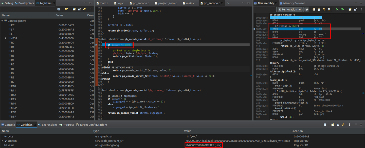

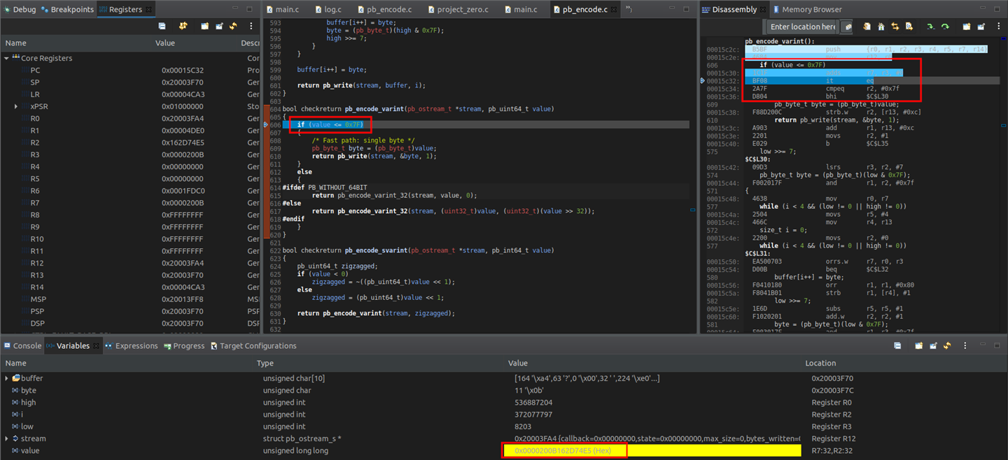

Digging deeper, it appears that the value <= 0x7F comparison is not producing the expected result within pb_encode_varint:
bool checkreturn pb_encode_varint(pb_ostream_t *stream, pb_uint64_t value)
    if (value <= 0x7F)
        /* Fast path: single byte */
        pb_byte_t byte = (pb_byte_t)value;
        return pb_write(stream, &byte, 1);
    else
#ifdef PB_WITHOUT_64BIT
        return pb_encode_varint_32(stream, value, 0);
#else
        return pb_encode_varint_32(stream, (uint32_t)value, (uint32_t)(value >> 32));
#endif
When run with optimization level 2, pb_encode_varint chooses the else case and calls pb_encode_varint_32 as expected.
With optimization level 3, pb_encode_varint chooses the if case and calls pb_write, even though value == 0x200b162d74e5.
Looking at the disassembly, I can see a difference between O2 and O3, but I'm not sure where the problem lies.
O2:
O3:
Is this a known issue with the 20.2.7 compiler? I've looked through the known defects linked in the release notes, but didn't find anything that looks exactly like this: 20.2.7 Known Defects.
