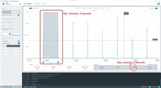

I have done some power analysis with Nordic power profiler PPK2 and attaching screenshots of the same.
I have changed advertising interval from 100ms to 5Seconds
also, in my code I have changed this values to increase the data reception time
#define DEFAULT_DESIRED_MIN_CONN_INTERVAL     4
#define DEFAULT_DESIRED_MAX_CONN_INTERVAL     20

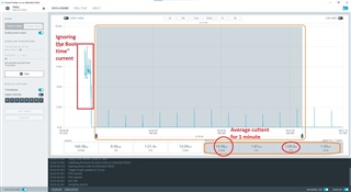

Aa of now The Device Average current is 19.98 uA (micro Ampere) for 1 minute of duration
So if I calculate the Battery Life of my device with above data
19.98uA  = 0.01998 mA (milli Amp) for 1 minutes
0.01998 * 60 Minutes  = 1.1988 mA for 1 hour
(CR2450 battery is 620mAH capacity)
620 mAh / 1.1988 mAh = 517.183850 hours
517.183850 / 24 hrs. = 21.54 days.

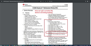

My other question is If I zoom into the waveform of power analyzer, between two advertising events there is some other power consumption taking place
(screenshot attached below)
As seen in Image there is some current of 50 to 55 uA and also there is current that never goes below 20 uA (microamp).
(If I disconnect the E paper, then also this current is present. So it is not being consumed by the E-paper)
Till now this is Unknown current to me
Second question -
Can you please guide me what is the source of this unknown current?
As per datasheet, standby current is 1uA.
Please guide me How can I reduce my device current to 1uAmp
Thank you

    But please guide me on these calculations,
    AVERAGE CURRENT FOR 1 MINUTES IS 19.98uA  = 0.01998 mA (milli Amp) (AS PER SELECTION IN PROVIDED SCREENSHOT)
    0.01998 * 60 Minutes  = 1.1988 mA for 1 hour  --- >    is this step really required?
    517.183850 / 24 hrs = 21.54 days.
    Is it required to multiply 1 minutes average current(0.01998 mA) with 60 minutes before division with 620mAh?
  • If you have a 620mAh battery and your average device operating current is 19.98 uA then the total number of hours the device can run off the battery is 620 mAh / 0.019 mA = 32,631 h = 1,357 days.  The total will be reduced when accounting for regular BLE communication over the device's lifetime, and you can determine the best output TX power for an optimal tradeoff between power consumption and performance
