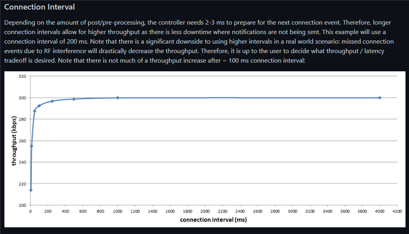

    The MSG_BUFFER_NOT_AVAIL return code means that there is no HCI buffer available at the time the GATT_Notification function is called. This information can be found in the Software Developer's User's Guide found in the BLE Stack SDK.
    In this case, you can retry at a later time. With regards to the connection interval, the value should be set to a higher value than 7.5ms in order to obtain the maximum throughput. At 7.5ms, the amount of downtime vs time spent transmitting is very high (2-3ms downtime per connection event) which will reduce the overall throughput as you have seen. The Connection Interval section of the Throughput Example documentation discusses this tradeoff:
    If you are sending your own custom data, then you will likely need to modify the blastData function to ensure the notifications are packaged and queued up properly with regards to the data you are sending. The Notification Queuing section of the example documentation. I would also recommend referencing the 5.3.5 Allocating Memory for GATT Procedures section of the Software Developer's Guide discusses the process for allocation memory as well.

    Indeed I started with the default configuration as per the Throughput example (connection interval = 100ms). As things did not work well, I doubted if there is a limit on the maximum number of notification packets in single connection interval. That is the reason why I reduced connection interval.
