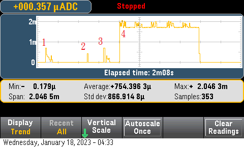

As shown below:
1: First power on and broadcast. Then Power Down
2: The external SPI is actuated, and the command is successfully received. Then it will Power Down
3. The external SPI is actuated, and the special command is successfully received... and the Power Down is not executed.
4. The external SPI is actuated, and the special command is successfully received... After that, it has been kept at 1.6 mA.
The power consumption will not be reduced until Power Down is executed after 5 communications. When SPI plays the role of SLAVE. In STANDBY state, how to reduce the power consumption to the uA level mentioned in the specification?

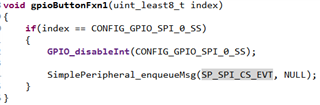

    The CS trigger condition is written as follows:
     The events in simple_peripheral.c are as follows:

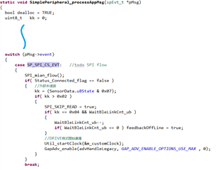

    In the above event, the call to SPI_main_flow() is as follows:
    The main rule is, if the content "A" received by spi is less than 2, execute Power_shutdown. Otherwise, enter standby.
    The problem is that it is also reading SPI. No other codes have been added, but why the power consumption is almost 2mA after entering standby.
    And it can't come down. Please guide if there is any special instruction to execute to make the power consumption down.
    In the red box, after all annotations are made, SPI does not receive data at all.
    On the contrary, with the red frame, the SPI can continue to receive data normally. But it also causes the power consumption to be pulled up from uA to mA in an instant,and it is maintained and cannot be lowered. How to modify and adjust to reduce power consumption?

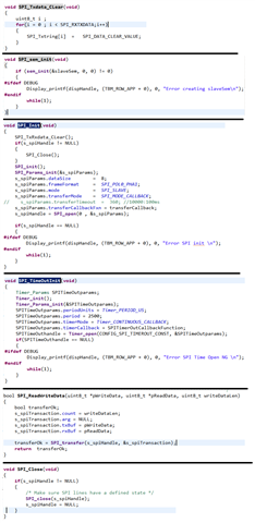

  • Hi Ryan,
    The further function are shown in the figure below:
    In addition, about the question 1, customer can confirm that he has not entered an error loop, because when DEBUG, the UART will continue to throw out the received SPI packet content.

    About question 2, he is not sure the SPI clock frequency of MASTER, but he has measured that each HI_LO of CLK is at least greater than 24us. And his current state is not that the data he receive is unstable but after SPI communication, there are also normal execution of SPI_Close() and other lines. Why the current has not dropped? (And at the moment of keeping high power consumption, he tried to remove the four SPI I/Os, and the power consumption was still maintained, and it would not fall off)
    Nick
  • The SPI can still be enabled and thus blocking LPM.  The customer should further debug their system to ensure that SPI_transferCancel and SPI_close are both called once the CONFIG_GPIO_SPI_0_SS pin returns to a high state.  They can also enable the transferTimeout to make ensure that SPI_transfer is exited in an appropriate amount of time.
