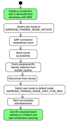

Here is the flow of the functionalities for the device under test (A).
STEP 1:
STEP 2:

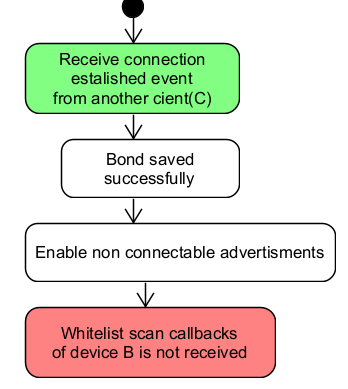

As described above, the issue comes when after A connects with C and non connectable advertisements start, the callbacks for the whitelisted device B stops.
1. Scanning has to be stopped and restarted to get the advertisements of B after STEP 2.
2. We verified that B is still advertising.
I have also tested other scenarios:
1. If whitelist scanning is not enabled in STEP 1 above, the scan callbacks of B are received even after STEP 2.
2. If B is not advertising with RPA, then whitelist scan callbacks of B will be received even after STEP 2.
Please help us through this issue.

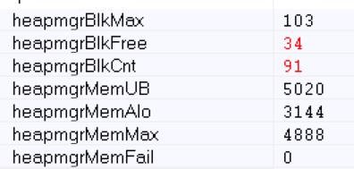

  • Hello Jan,
    I have observed that this issue is not reproduce-able on the base multi role project with MAX NUM BLE CONNECTIONS set to 1. Below is my memory status:
    1. When application starts
    2. When connection established with B and A starts whitelist scanning of B
    3. After mobile connection and when whitelist scan stops
    Also the detailed task stack status:
    Does not look like there's any heap failure.
    We need to look into our application flow and see where it's causing a problem.
    Mohini
