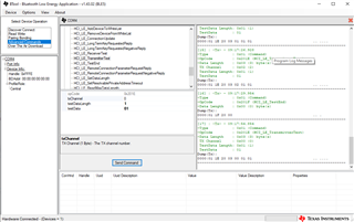

 We're trying to use Btool for testing cc2340r5.
 Btool has some responses at the first but then it doesn't response any more when we try to send other hci cmd (ex HCIExt_SetTxPowerCmd, HCI_readBdAddr......)
  • Turn on the Btool at first time:
Btool_first_connect_response
  • No response when we try to send other hci cmd
Btool_no response

  • Hi Mike,
    The Bluetooth test commands (HCI_LE_ReceiverTestCmd, HCI_LE_TransmitterTestCmd, HCI_LE_TestEndCmd) are implemented and can be used.
  • Hi Clément ,
     I try to send these test commands by BTool (HCI_LE_ReceiverTestCmd, HCI_LE_TransmitterTestCmd, HCI_LE_TestEndCmd) , but CC2340R5 has no responses.
     It's something I need to set up?
    Mike
  • Hi Mike,
    I think the issue is caused by the commands automatically executed by BTool.
    Can you please follow this?
    - connect BTool as always and let BTool execute the commands
    - press the device's reset button
    - execute the command HCIExt_ResetSystemCmd
    - execute the test commands
    I hope this will help,
