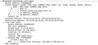

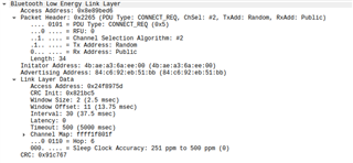

I have a CC2652 using SDK 06.30.01.03 and the BLE Stack that comes with it. I am unable to connect to the device with certain devices. The Google Pixel 3A and 5 both failed to connect while a Pixel 6 and Samsung S21 were able to connect without issue.
I was able to capture the connection request issued by the phone for both the Pixel 3A and the Pixel 6. Unfortunately the device used to capture the packet hangs for a second when it receives a connection request packet so I don't have any further packets in the connection procedure. I know the CC2652 receives the connection request based on logs from my application but I'm not sure if it is responding. The CC stops advertising and scan responses after a failed connection, but not after or during a successful one.
The Pixel 3A Failed Connection:
The Pixel 6 Successful Connection:
