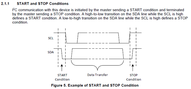

I'm using the LaunchPad CC2642R/CC2652R with the I2C protocol and ATECC608A accelerometer. I have a issue with the status:
Could you please give me a recommendation to solve it?
Question: START and STOP Conditions are changed in I2C (Library)? I was trying to comply with the command: GPIO_setConfig(CONFIG_GPIO_I2C_SDA, GPIO_CFG_OUT_STD | GPIO_CFG_OUT_LOW);
My code:
if (I2C_transfer(i2c, &i2cTransaction))
GPIO_write(CONFIG_GPIO_LED_0, CONFIG_GPIO_LED_ON);
}else
GPIO_setConfig(CONFIG_GPIO_I2C_SDA, GPIO_CFG_OUT_STD | GPIO_CFG_OUT_HIGH);
if(I2C_transfer(i2c, &i2cTransaction))
}else{
