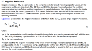

For mass production, we did 48MHz crystal matching and got the same result as the below
The crystal matching company said that the paternal resistance value came out to -150 ohms, but it must be at least 1000 ohms to mass-produce.
So I have an inquiry as below.
1) I would like to know how to increase the value of the paternal resistance.
2) Although it is a similar inquiry to the number 1), I would like to ask if there is a way to increase the negative resistance value through S/W modification.
Please refer to the 48MHz crystal matching results, crystal DATASHEET in the attached data.

  • Hi Robin,
    1. Technically, you can adjust the negative resistance based on the equation below but the load capacitance is limited to the spec we recommend which is 6 - 9 pF. Please understand that this method merely changes the phase of the crystal which in turn changes the resistance and not the actual resistance.
    2. Not possible
