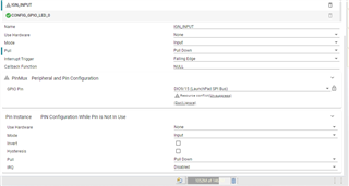

i am working with simple peripheral code; current SDK version is simplelink_cc13x2_26x2_sdk_5_10_00_48.
i am configuring the switch for wakeup from shutdown.
if i try to put the controller into the sleep mode; it went to the sleep mode.
but after pressing the switch its not wakeup.
above image refer to the GPIO pin configuration.

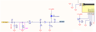

please find attached pin schematic snap for your reference.
attached code snippet is called into the main function.

    I am not sure I understand your last observations. May I kindly ask if you are running the code on a LaunchPad or on custom hardware?
    I suggest you check if this is correct
    PIN_Config ButtonTableWakeUp[] = {
    IGN_INPUT | PIN_INPUT_EN | PIN_PULLDOWN | PINCC26XX_WAKEUP_NEGEDGE,
    PIN_TERMINATE /* Terminate list */
    Also, if your input signal will trigger the wake up from shutdown mode by using a oscilloscope.
