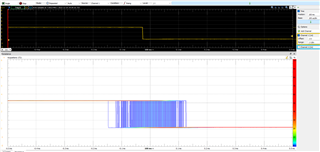

  • Hello Ryan and thanks for such a quick response.
    I now see a fault in my initial post. The fault is 0.2ms, not 2ms. We are measuring frequencies up to 500kHz. So the total fault could be up to 1kHz, which is to much (if the interrupt is consistently 0.2ms off).
    We are using a custom board.
    CCFG are set to "#define SET_CCFG_MODE_CONF_XOSC_CAP_MOD 0x1 // Don't apply cap-array delta". But have not done more than that.
    To measure the time of the interrupts, i made the interrupt handler toggle a GPIO connected to a test point on the board, then connected a oscilloscope to the test point for monitoring. Will try to attach a picture to this post.
    As you see from the initial code, i added 2 systemticks to the timer to make it closer to 100ms.
    Ole

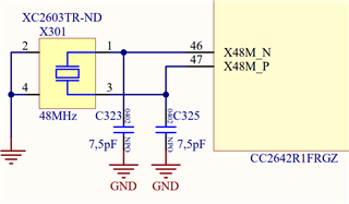

  •  This is how the crystal is mounted on our custom board.
  • You should consider evaluating a LAUNCHXL-CC26X2R1 to determine whether behavior is any different with this hardware, reference SWRA495 for crystal oscillator recommendations, and also submit your hardware design to SIMPLELINK-2-4GHZ-DESIGN-REVIEWS for further review.
