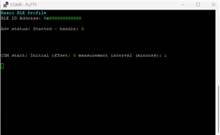

Serial UART Output after successfully flashing the basic_ble_profiles :
Note: BLE ID Address is printed as - 0x00000000 , Is it normal?

    First can you confirm me that you are using the same code on the exact same device. (Did you only change the SDK?)
    If yes, this last SDK is for the new revision of the device and this behaviour is normal on your device.

    This revision of CC2340R5 doesn't work with the SDK - simplelink_lowpower_f3_sdk_7_10_00_11_eng.
    You need a PG2.0 device to use this SDK, so its behaviour is normal for your case.
    If you want to keep your actual device, please use the previous SDK simplelink_cc23xx_sdk_6_41_00_09_eng.

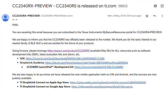

    Yesterday we got this mail from TI team, they suggested to use LP-EM- CC2340R5 with the SDK - SIMPLELINK-LOWPOWER-F3-SDK , but as per our previous discussion, this revision of CC2340R5 (Rev: E3) doesn't work with the SDK - SIMPLELINK-LOWPOWER-F3-SDK.
    Please clarify, do we need to change anything in the existing board to support the latest SDK or It will work as it is, if there are changes in the hardware than, can you please specify the hardware changes so that we can test the latest SDK.
    Harinder Singh
    You received that mail as the CC2340R5 is finally released. The previous mentioned board, was for the pre-release.
    Here the latest SDK is for CC2340R5 revision B (also called PG2.0) material. The CC2340R5 revision B evaluation modules can be ordered on https://www.ti.com/tool/LP-EM-CC2340R5.
    Unless said otherwise, all the CC2340R5 samples and evaluation modules shipped by TI from now are CC2340R5 revision B (PG2.0) material
