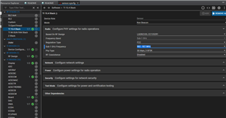

  • HI Alex
    Thank you very much for your help, but there is a problem in performing this step.
    5.) Open the collector.syscfg file and avoid that the files: ti_154stack_config.h, ti_radio_config.c, ti_radio_config.h are overwritten when rebuilding with the help of the include in build slider
    No matter what I do, either the compilation is wrong or the file:ti_154stack_config.h, ti_radio_config.c, ti_radio_config.h  is overwritten.
    I'm a beginner in TI development tools, can you provide a mapping for this step? I would be very grateful if I could get your reply.
    Tdy

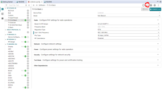

  • Hi Werwer,
    of course I will.
    1.) Build all your projects
    2.)  Go to the the collector with the 433 MHz settings of your chip and copy the marked files:
    3,) Paste those files to the project folder of the design you would like to change. Afterwards it should look like this:
    4.) Press build to
    4.) Open the collector.syscfg in this project and press on <> (marked red)
    5.) Now your will the the slider. Use them to exclude the three files: ti_154stack_config.h, ti_radio_config.c and ti_radio_config.h. Your screen should look like this:
    6.) Build your project and flash it on your board.
  • HI Alex
    Thank you very much for your help, my code is running happily!
