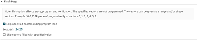

I am working on a CC2340R5 application using NVS memory. I would like to skip NVS sectors while programming the device to retain the data.
Either with CCS or UniFlash, it is not working.
CCS:
Uniflash:
No error, sectors are just not skipped.
I wanted to know if I am doing something wrong or if this feature is not available yet?

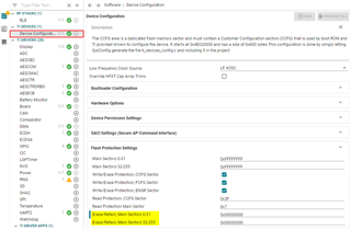

    I would recommend to first verify if the sectors are erased or not. Based on the screenshot you have provided, I would expect they are erased as you have selected the option "Chip Erase". It seems the option "Chip Erase (Retain sectors specified in CCFG)" should be selected instead. Of course, selecting this option suggests you have properly setup the Erase/Retain sectors in the CCFG using SysConfig:
    Assuming the sectors are not erased (but written), I would check (for sanity) whether the sector numbers should be separate by a coma and a white-space.

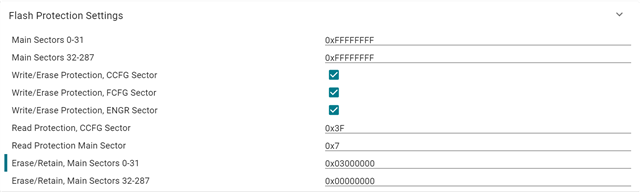

    Thanks for your answer, I was definitely missing the SysConfig part!
    Here is my configuration:

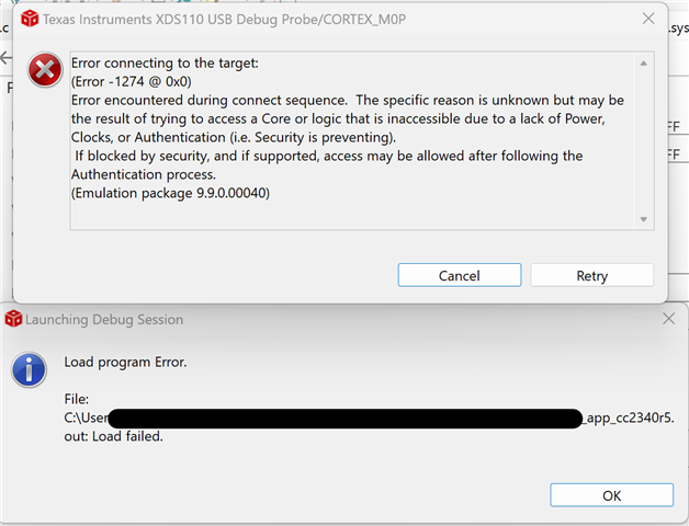

    As I was fearing it when you suggested using the "Chip Erase (Retain sectors specified in CCFG)" option, I am running into problems I already had when trying to flash the unit either with CCS or UniFlash.
    Uniflash:
    CCS:
    This does not happen when using the "Chip Erase" option.
    Any idea what's going on?

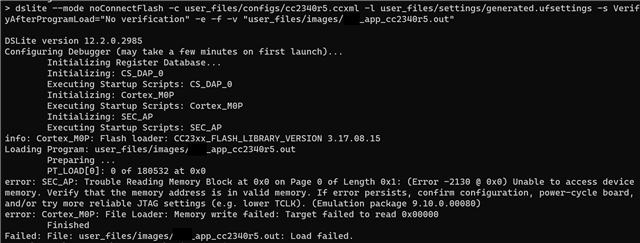

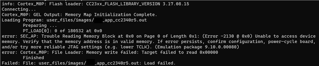

    I tried using Uniflash's CLI and got similar results with the default --mode flash:
    And with --mode noConnectFlash:
    I generated the package using the Standalone Command Line tool.
    Hope this will help identify the issue.
