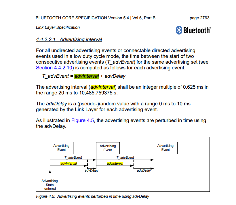

Hi TI team,
In my project, there is a requirement that need to change advertising interval. During testing with Sniffer, I see that the interval is lower than my configuration (example 30ms).
According to SIG, it should have AdvDelay random value from +0ms ~ +10ms but how about the  -0ms ~ -10ms. Is it normal behavior?

    I had a look at the Bluetooth Core Specification, and you are right, is not that clear.
    To my minds, the advDelay value could be positive or negative, thus your Bluetooth LE traces have a totally normal behaviour.

    After discussion with the right team, your behaviour is totally expected. My apologies on the mistake concerning the negative advDelay, that's wong.
    So for instance, let's say our interval is 30ms,
    Advertisement 1 is delayed by 30ms + 2ms
    Advertisement 2 has NO delay so it's now 30ms - 2ms from the previous event
    It appears that the second advertisement had a -2ms "delay", when in reality it wasn't delayed at all, but because the previous advertisement was delayed it appears that way
    Does that make sense for you now?
    Hope it will help you for the understanding of advInterval.
