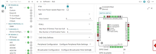

    I tried to add PTM mode following the link you posted. I opened sysconfig from CCS of my project and enable the PTM checkbox, but nothing has happened: no files modified (expect the sysconfig one where the line ble.ptm = true has been added) or added.
    What am I missing ? What should i cjeck ?
    If I try to add a new ADC for example on a pin that I am not using, it is working, so sysconfig and the CCS are ok

    To confirm, can you specify which project you have checked the enable PTM box on? Is this on simpel_peripheral?
    Jan
    no, it is my project, I have a custom board. Anyway, I think it was started from simple_peripheral. Why ?
  • Hi Stefano,
    The PTM box on Simple peripheral project change just the max number of ICall Enabled Tasks from 3 to 4.
    On your project can you confirm that?
    You can see the number of "max number of ICall Enabled Tasks" in Advanced Settings > Icall
    yes, this number is increased and also PTM_MODE defined has been added I think.
    But then what is needed to have PTM working on my project ? I have to import NPI, etc ? How ? There is a guide to do that ?
    Normally it should build without errors and it's the only thing you have to set to "unlock" PTM mode on simple_peripheral. NPI are already in the example so no ned to import them.
